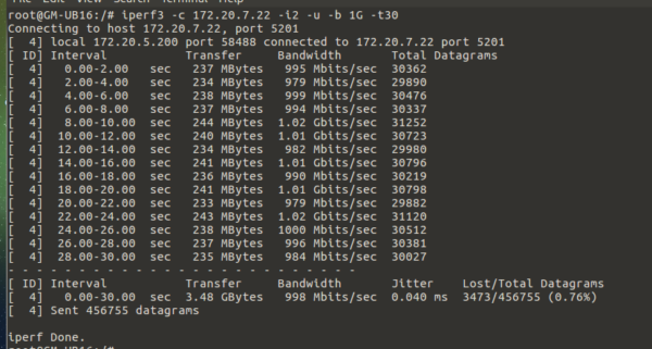

UDP throughput:
Server: iperf -s
Client: iperf3 -c 172.20.7.22 -P 2 -t 10 -b 1G -u
With these results, we can see:
- Packet loss
- If UDP traffic is allowed
- The network jitter (Jitter is the variation in the delay of received packets, as a result of network congestion, improper queuing, etc.)

For the first test, run the test as we did before using the following commands:
- Server: iperf3 -s
- Client: iperf3 -c 172.20.7.22 -i2 -t30 -b 1G -u
