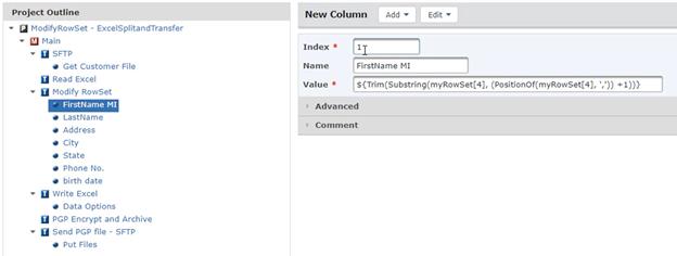

Beginning with the first name, a column is created called “FirstName MI,” representing index number 1. Within the Value is where multiple Functions will be used to modify the original record. A Substring Function is done on column 4, starting at a position just past the comma, going to the end of the string.
